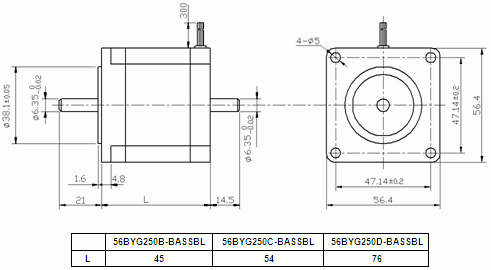

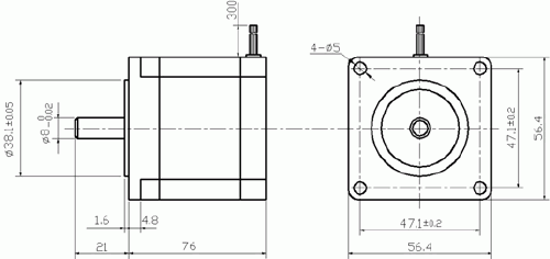

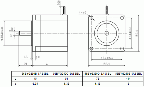

外形尺寸 单位:mm
56BYG250x-SASSBL-xxxx
56BYG250x-BASSBL-xxxx
56BYG250D-SASSHL-0241
