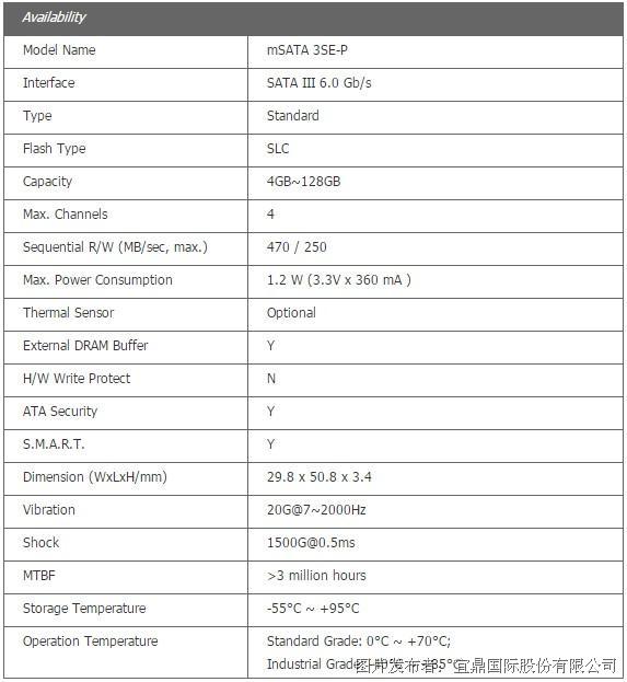

Features
SATA 6Gb/S interface
SMART disk health monitoring
Intelligent error recovery system
Excellent data transfer speed
Great I.O.P.S for best system reaction
Dram buffer
Zero mechanical interference
Anti-vibration mechanical design
JEDEC standard MO-300 dimension
Overview
Innodisk mSATA 3SE-P is designed as the standard Mini PCIe form factor with SATA interface, and supports SATA III standard (6.0Gb/s) with excellent performance. The form factor refers to the MO-300 specification which established by JEDEC. Regarding of mechanical interference, Innodisk mSATA 3SE-P absolutely replaces the traditional hard disk and makes personal computer, in any field, smaller and easier.
Innodisk mSATA 3SE-P effectively reduces the booting time of operation system and the power consumption is less than hard disk drive (HDD), and complies with ATA protocol, no additional drives are required, and can be configured as a boot device or data storage device.
