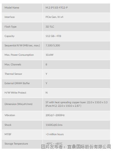

产品特色
PCIe Gen. 4x4, NVMe 1.4
Excellent data transfer speed
Stable sustained performance
Heat-spreading design
LDPC ECC engine supported.
Thermal Throttling management
Overview:
Innodisk M.2 (P110) 4TG2-P is an NVM Express SSD designed as the standard M.2 form factor with PCIe interface and 3D TLC NAND Flash. M.2 (P110) 4TG2-P supports PCIe Gen. 4x4, and it is compliant with NVMe 1.4 providing excellent performance. M.2 (P110) 4TG2-P with heat-spreading design dissipate heat generating from IC making SSD perform more steady. M.2 (P110) 4TG2-P has Die RAID protection to reduce bad blocks happening and optimize data integrity.
Innodisk M.2 (P110) 4TG2-P provides ultra-speed and high IOPS and offers maximum capacity up to 4TB, making the SSD optimal for server and heavy data workload applications.
