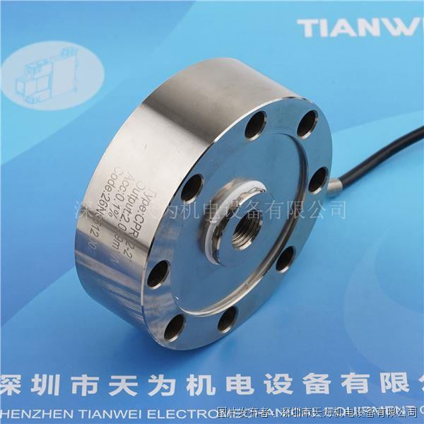

KEPURUI科普瑞轮幅式称重传感器CPR12-2T
产品用途和特点:
●轮幅式传感器,优质合金钢材质
●安装简便,稳定可靠,适用于实验机,汽车衡及大型料斗秤等
产品规格:
量    程Capacity:0t~30t
零点输出Zero balance:±1%R.O.
额定输出Rated output:1.5~2.0mV/V
零点温漂Temp.effect on zero:≤0.002%R.O./℃
非线性Non-linearity:0.03%R.O.
蠕变Creep:±0.03%R.O./30min
滞    后Hysteresis:±0.03%R.O.
灵敏度温漂Temp.effect on output:≤0.002%R.O./℃
重 复 性Repeatability:±0.03%R.O.
工作温度范围.temp range:-10℃~70℃
温度补偿范围Compensated temp range:-10℃~50℃
输入阻抗Input impedance:700Ω±5Ω
输出阻抗Out impedance:700Ω±3Ω
绝缘阻抗Insulation:≥5000MΩ(50V DC)
推荐激励电压Recommended excitation:10V DC
最大激励电压Maximum Excitation:15V DC
导线长度Wire length:4芯屏蔽电缆 φ 5*3m
安全载荷Safe overload:150%R.C.
